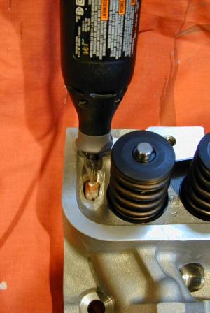

Step one was to modify the oil drain holes to prevent oil from accumulating in the corners, and drain quicker.

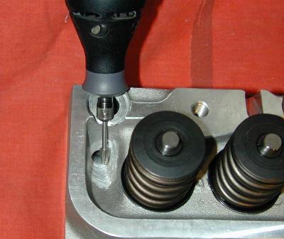

First, the holes were ground out larger, and tapered using a Dremel grinder. There's lots of meat here, so don't worry about cutting into a water gallery or anything. This mod can be done without removing the valve and springs, but be careful not to accidentally nick the valve spring with the grinder...
Next, the metal was polished smooth....

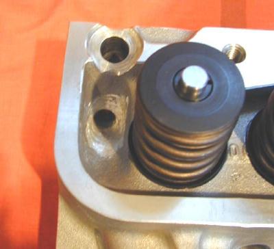

The resulting hole eliminates the sharp edges and provides a more funnel-like drain shape...
