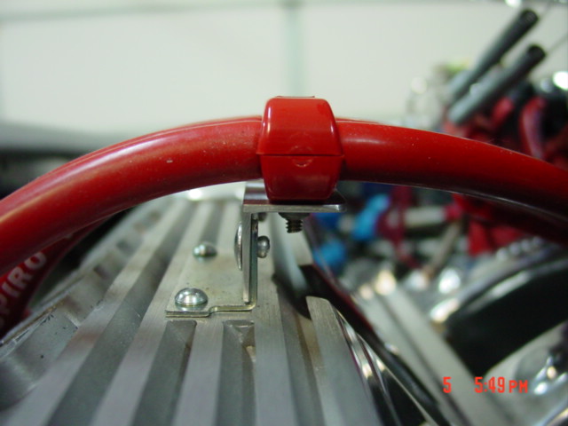

Here's how we had to mount the 10mm wires we are using .....
Just made a bracket out of Angle aluminum and riveted it to the valve cover and installed Nut-serts in the top and screwed the 4 hole loome to the bracket....
Easy and clean and works for 10mm wires
