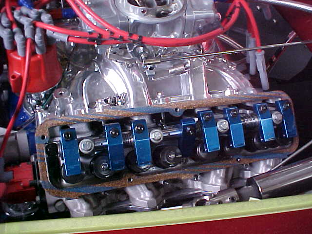

FE gods tell me what the engine builder did to me here

missing spacers?

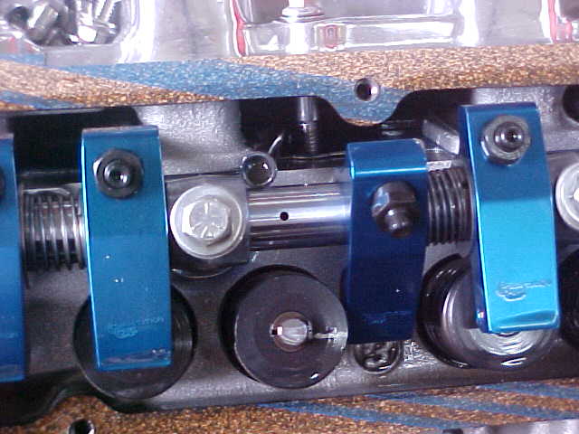

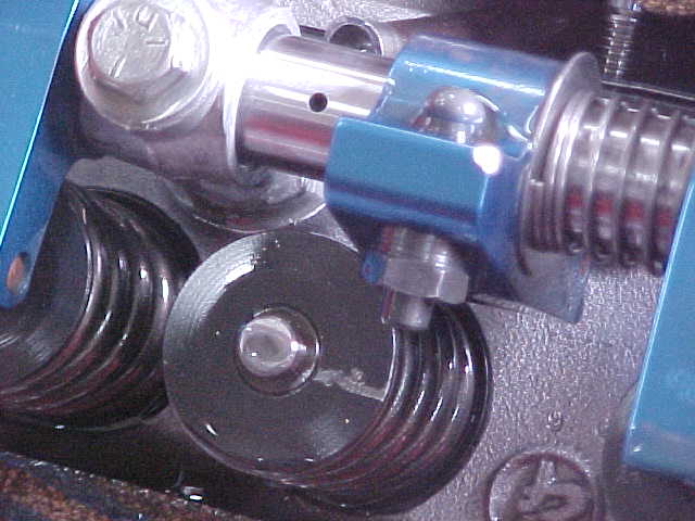

Those appear to be Competition Cams Rockers which going by the pic in their catalog should have Spacer Tubes- not springs between each pair. They are also 'Handed' in reference to the adjuster screw for clearance in the pushrod area. Yours appear to have been fitted correctly in reference to that -just no spacers!

Yours rockers look like mine except mine have these spacers...
http://cgi.ebay.com/ebaymotors/FORD-...QQcmdZViewItem
I think your rocker jumped the track...

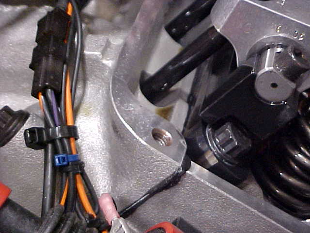

Looks like #5 intake has jumped the track as well. Who was the builder? We need to know so we can avoid him later on...
07-19-2007, 07:12 PM
Posts: 3,841
Ed is the rocker nut loose?
Ed couple of things, The pushrod has no marks on it? Is it bent, roll it on a flat surface to check. I there a good rub mark on the inside of the rocker by the shaft? The picture is not clear in this spot. It looks like the adjust nut was not tighten down enought and backed off the rocker. The spring keep the rocker in location over the valve. I would say without see the motor that these 2 rockers where loose after adjustment and when reved up it poped the pushrods out of place. Make sure the threads in the rocker are not stripped. 400 lbs of spring pressure when opened could have cause this to happen. I would also check for spring bind with the valves all the way open. safe spec is .100" between coils. Check the 2 lifters and cam lobes on these bores, If the cam went flat same thing will happen. Check the bottom of the lifter for damage. Cam lobes could be wiped. If solid or hydro lifters you can get them out with a magnet and not have to pull the intake. If you want to talk, call me 732-254-3536 Rick L. Hope for just loose adjuster nuts

Push rods bent 4 of them and three valves one even throw a keeper the builder was I will hold off for now this is not all that has been wrong with this deal I cant even tell you how pissed I am My customer has been waiting two years for this car almost one year was waiting for this motor. Hell I don't want to talk I need a hug  thanks guys

My rockers look much like yours, but mine use spacers, not springs. Could be loose valve lash or springs for this application are incorrect. Valve train geometry (clearance of push rod in several areas of measurment for example) is often over looked. Proper clearance is 'assumed' rather than verified. Verification of ALL items on a motor is what makes one builder 'great' and another an 'also ran'.

Just from looking at the pictures there seems to be a lot of "unusual" techniques at work.
The rocker arms appear to be Dove roller tip rockers.
Judging the gauge of spring wire used, the lack of shims in needed positions, along with the lack of spacers as well it does raise questions about the configuration, duh.
Are the lateral springs strong enough to hold their length or are they easy to compress? From what has occurred they don't appear to be doing their job.
There is a respectable amount of lateral pressure exerted during mid-high rpms. Thats why spools are used in a lot of set ups and not just springs.
In your last shot there does not appear to be any spacers or shims mounted on the shaft between the rocker and the shaft stand, which would allow the side wall of the aluminum rocker arm to rub directly against the steel shaft stand.

If the valve clearance is set right this should not happen even with springs.Bent valves and pushrods would maybe suggest that you experienced spring bind,like suggested above.What lift do you have on that cam?

The motor was picked the motor up he's only 20 minutes from me the valves were not left lose for shipping  For the question on how I know the block was not decked easy the finish is terrible and you can still see the old round ring from the old head gaskets the new gaskets he used were not round and leave a different shape on the block. Better yet I got out my trusty machined strait edge and feeler gauge set and in places I got up to 5 thousands. I reinstalled the rocker shafts and push rods after the intake was off and it toke no effort at all to slide the rockers sideways and send the push rods flying. The valves in question are damaged at the rocker end the push rod got jammed in a few real good when the rocker started to go sideways. Hell even one lifter popped its clip and blew apart, I have been at this for a long time with many engines under my belt just not allot of fords. This is one of those deals were you know what is wrong but you just need to hear it from some one else to be sure of your self.
