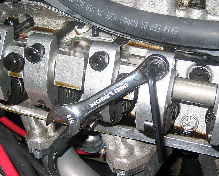

I agree with Rick. Erson's look as nice as they perform too. I have solid lifters with my Erson's and they hold their lash particularly well. Here's a shot:
