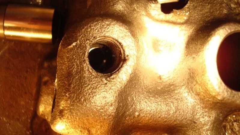

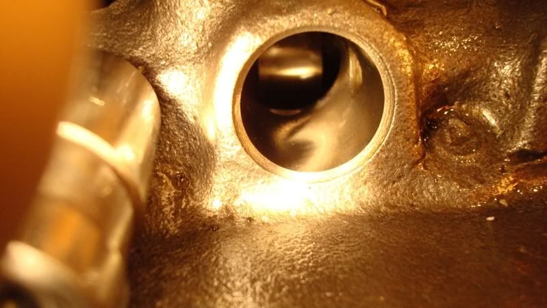

Here's a couple of pics.
http://i37.photobucket.com/albums/e7...anspassage.jpg
The first photo is down the hole under the allen set screw that covers the passage from the main center gallery to the lifter gallery.
http://i37.photobucket.com/albums/e7...ithoilhole.jpg
The second link is looking down the lifter bore where you can see that the oil passages are there - just plugged.

If its been plugged with a small 'cup' type gallery plug you should be able to punch a hole in the center & screw in a coarse thread screw to remove it. But I have a gut feeling that you have an original mech cam block and those two drilling from the main gallery to the lifter galleries have never been made, in which case you will have to do so in order to run the hyd cam. To do it 'right' & ensure no debris gets into the main gallery to cause future problems its going to have to be stripped-again. Or you have the option of going back to mech cam/lifters on this or both motors.

Could the lifter bores be drilled out without drilling throught the area at the bottom of the main gallery to lifter gallery transfer passage? That's the reason I was leaning to some sort of cap put in after the fact.

If the drilling's extend virtually down to the gallery for the lifter bores, but for some reason have not been 'broken thru' into that gallery then by using a very slow drill it might be feasible to do just that aided with magnets, shop vacuum, etc to catch the chips. Still scary though, only takes one chip to find its way down to a rod bearing to ruin your day. Not worth the risk IMHO.

hard to tell what is in that hole from the picture. spin the oil pump with a drill and see if oil comes out of the lifter bores. if no then they might have it plugged in another location. to the right of your cam in the front of the block there is an access hole, to the oil galley plug. this may be a pressed plug or a pipe plug. behind it there may be a plug pressed in there, it would be about
3\8 in diameter, this blocks the left bank. also check the rear of the motor, at the cam plug
are there two removable plugs at 10 and 2 o'clock if no then its not a hydraulic block if so they might have the galley blocked there.

that looks like the oil feed to the lifter, the plugs need to come out if you are going to run hydraulic.
Post 64 427 blocks could be finished either way I believe.

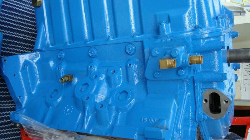

Yes it's the original engine that came with the boat (Hatteras 38) in 1968. There's a handful of these sideoilers around the boat scene. I know of 4 others. There are PLENTY of topoiler 427's though. Speculation is that Ford got stuck with a shortage of inventory at some point in 1968 and had to ship these side oilers to fill an order to Chris Craft who did the marinization. No doubt a waste of good machining, but if that's what it took, well so be it.
I don't blame your skepticism regarding whether it's REALLY a side oiler. I've talked to more than a few people who are confused about what it is. If seeing it will help you believe, here's a picture.
http://i37.photobucket.com/albums/e7...v/leftside.jpg
Interesting though about your friend having to drill out the bottom of the passage.
Eric

from the pic, it looks like the side oil gallery feed to the bearings are drilled, that is they have plugs, but, from the back of the block, it should have two gallery plugs down near the drivers side bottom of the block where the main galleries were gun drilled.

It sounds like the guys that worked on your engine did not even have the top oil galley plugs out of the engine or they would have seen that these were blocked. They should clean every oil galley well before they assemble an engine and if they had done that they would have sen these galleys blocked. Ford drove a solid pin in these galleys and you pretty much have to drill them out when you have the engine apart. We even like a small amount of oil going to the lifters when they are solid flat tappets to help oil the bottom of the lifter for better life. This where some people know what to with a FE angine and some don't.
We have even started oiling the pushrod cups up through the pushrods since the oiling through the shafts is not very good and will show signs of heat with any spring pressure at all. You have an endurance engine so some oil through the lifter passages would not be a bad thing with the solid lifters as well.
