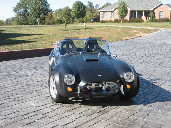

I have a Shell Valley Cobra with a 427 fe,I have a heating problem at high speed.When I travel on highway for a distance temp. begins to climb 210 or more degrees,When I stop at light temp falls down to 195 or so,changed water pump from eletric to manual,changed thermostats,adjusted timing.Think radiator capacity to small,radiator holds 5 quarts water alone,looking at double pass raditor, Any suggestions please,Thanks Toren

You may not have enough airflow trough your radiator. That happens if it is not shrouded to funnel air, instead of bypassing the core.
Can you post a pic from the front of your car?

I have aluminum shrouding in front,have 2 pusher fans in front, 1 puller fan (perma cool brand)with shrouding behind

Your shrouding might be blocking too much air flow at speed. I know Spal utilizes one way flaps in their fan shrouds to minimze this.

Although it may be the sizing of the Radiator, I would also look at the possibility of the pusher fans creating a "wall" that is blocking the the incoming air while they are spinning.

Wouldn't the incoming air just spin the pusher fans and then continue on through the radiator? I've never had a problem with that, but unbolting them and taking the car for a ride at speed would be a pretty easy test for him, I guess.

You might try removing the pusher fans in front. They can obstruct air flow and are useless at speed anyway. Also verify the puller fan is blowing the correct direction and sucking air through the radiator. Have you burped the block? Bring the temp up a bit and loosen the temp sensor in the intake to let out any trapped air.
