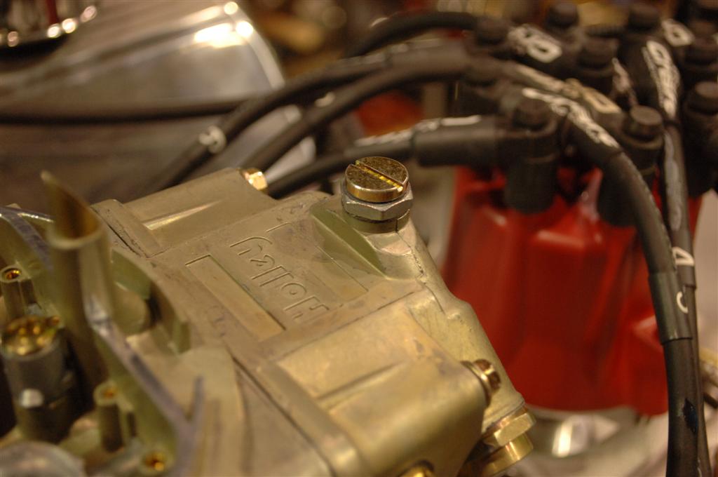

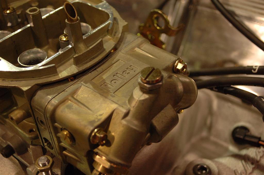

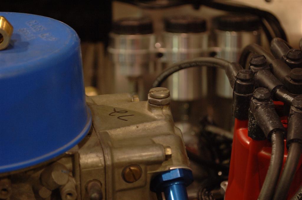

Holley has new float bowls

Demon envy?

The new gas was eating the insides out of a run of the earlier ones. They're making good on it as they had too much lead in the alloy I think it was. The new ones may be to differentiate from the old.

Did you cut the choke tower or is that a new feature also???
We cut it.

The needle and seat appears to sit higher on the new bowls.

Two different model carbs also?
Craig
Yes, the new one is a 830 DP, the old one is a 650 DP. But my older 830s have the old style float bowls.
You are correct.
I will pull off the float bowls on Monday and see what is different on the inside.

Just went to the Holley site & most all 4brl d/p seem to have the new float bowls.
I guess it is a across the board production change.

Probably to aid in fuel flow entering the bowl.

Well that float bowl will mess up low profile air cleaner systems. -- fuzz.

i would guess different manufacturer. any guesses?

I bought a 650 dp from Summit ( 4777-7) about a year ago, it is the "new" style" as shown above.
Yeah, that sticks up a whole bunch, don't it?
I had to drill out a port on my long oval to get it to fit the Holley - old style, BTW - and then extend the hole to let the AC sit down over the Speed Demon's float screw. I sealed it with a rubber gasket from a fluid cap (generic part, the kind with a stiff outer ring and a soft bulls-eye center) epoxied to the lower AC plate. The float screw pushes up through the soft center and the outer ring acts as a bumper against the top of the bowl. Works great, even looks good.
