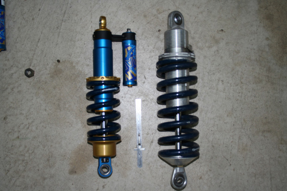

scottj
Ralphy,
I've have Dynamic dampers with 2" ID x 5" length Hypercoils. I think they go up to 3000#/in. When I was on the 2.5" ID springs I ran 2.5 ID x 7" or 8" Hypercoils and they went to 1300#/in.
