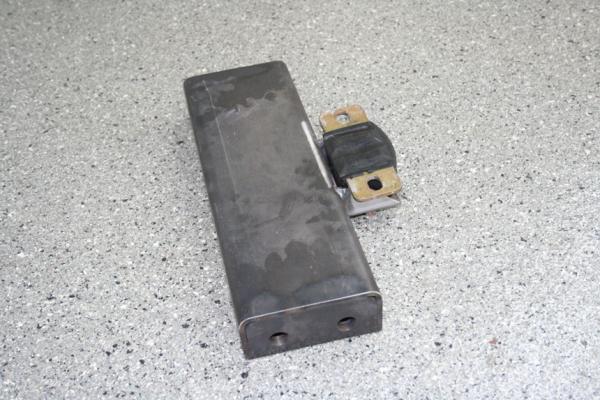

scottj
I had to fab a new crossmember 6" rearward.
with a 1-3/4" dropped mount.
I also move the engine 3/4" to the passenger side.
The lowest point of the trans ended up 1" below the frame.
