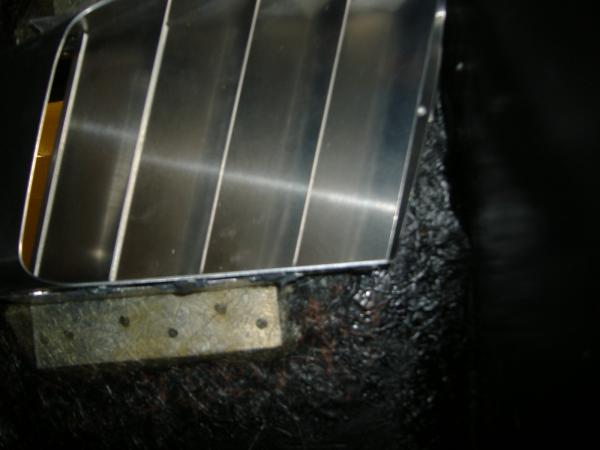

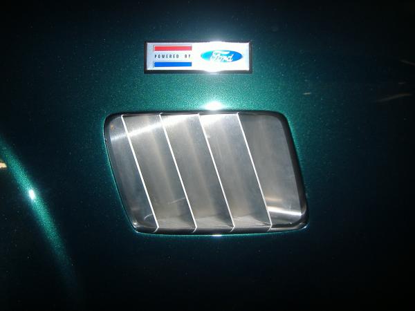

Hey Randy, OH Yea, had mine out. Rolled it out of the garage so I could sweep and clean up the puddles of brake fluid. Im going to get a new line made today. I have been trying to make my own louvers which Im having troubles with. I guess because my openings still have the 3/4 inch lip on the inside. Anybody else know how to do this? Still waiting for OKC for paperwork also. Making progress slowly. Hello to the group! Anybody need help with anything? Wayne? Eric? Just holler. c-yas, Phil

Phil,
Mine still has that 3/4" lip too. I got my louvers as a present, I know they came from Finish Line and now cost $85.00. They now come with brackets but when I got mine they didn't. So, we epoxied two "L" shaped brackets to the louvers & then glassed them in the body openings from inside. I attached a few pics that shows it. It turned out good & was easy to do. Give it a try.
