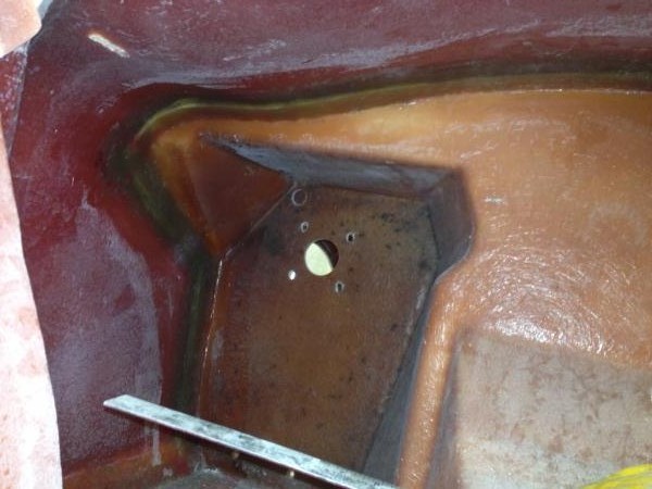

acoulson
We decided to make a one piece body and completely integrate the tub to the body. He is a pic of the the steering column foot well and seam between firewall and body.

mdross1
I remember test fitting ours and it was very good all the way around.My only concern was how to pull the sides tight without forcing the center of the body up off the tub.Once it was bonded I used more fiber cloth to make certain the joint was permanent.
The big thing is the body sitting on the frame with no stress thus the shims
