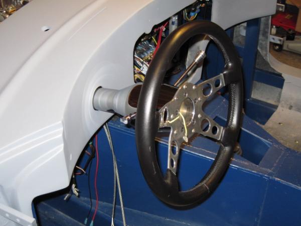

I have an IDIDIT. I'd probably go for the Double D design off the shaft. I used the splined column. I also put the dampener at the end of the shaft, then a slip coupling before the mount on the frame. I changed the mount to a Stainless Tie rod end. All my steering components are Borgeson. I had a bracket made to adapt the 2nd mount, as is offset. It works great, much better looking than the crap you get off a used Mustang. You'll need to patch your dash panel.

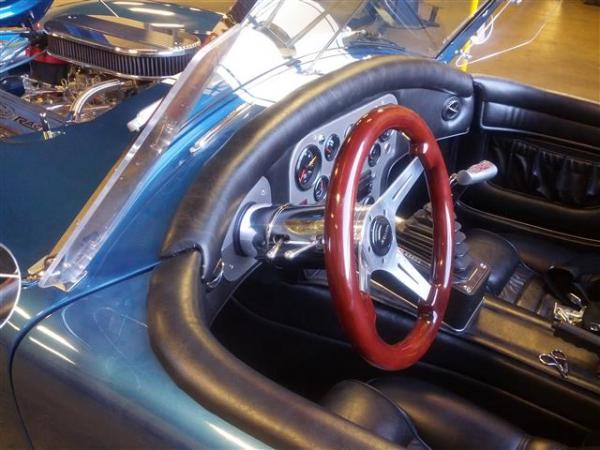

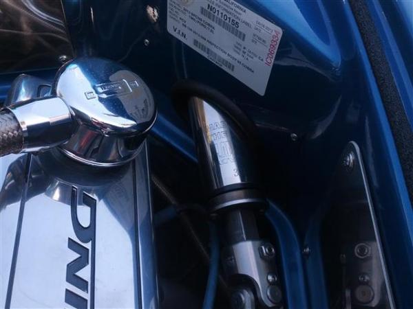

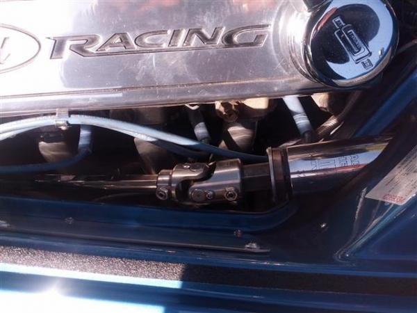

Yep, already done. Put column through firewall a few inches and took off the "steering box" that is screwed into the firewall, no need for it. Fiberglass modifications required but trimmed it out nice. Actually I have more room for plug #4 without that box and he dropped shaft lower. Prior installation had the shaft swivel rubbing on the the front head bolt, terrible installation. Trimmed out dash to match aluminum dash panel. I will post some pictures. Raining today, not good light. Darryl did a great job.

BOBOCobra
Here you go. No problems with fit. Wheel is a little smaller but thicker and I like it.
