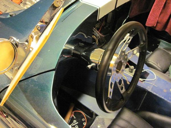

I'll post some pics soon. I'm working on getting the front end completed and installing my gas tank still... Your problem may very well be the worn out Ford column if it's a tilt wheel. Perry (ex WCC Dealer) told me a story that he built a car for Vern and when the customer test drove it he nearly wrecked it because the tilt wheel from the junk yard was worn so badly. I tossed the old column and used an IDIDIT chrome column with no tilt. I'm partial to the look of the vintage dash. The WCC/Kellison uses the plastic cover which detracts from the appearance. While my column is not stock AC, it works well by moving the steering wheel back to me in the drivers seat as it gives me more knee room.
04-12-2012
07:28 PM
permalink
Xack
Photo 1, Borgeson Stainless Steel Steering universal joint and Stainless Steel Rod End, 3/4" ID
Photo 2, Ididit steering column installed but not correct rotation yet.

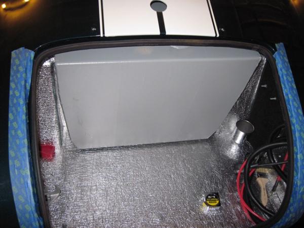

Photo 3, New gas tank installed.
