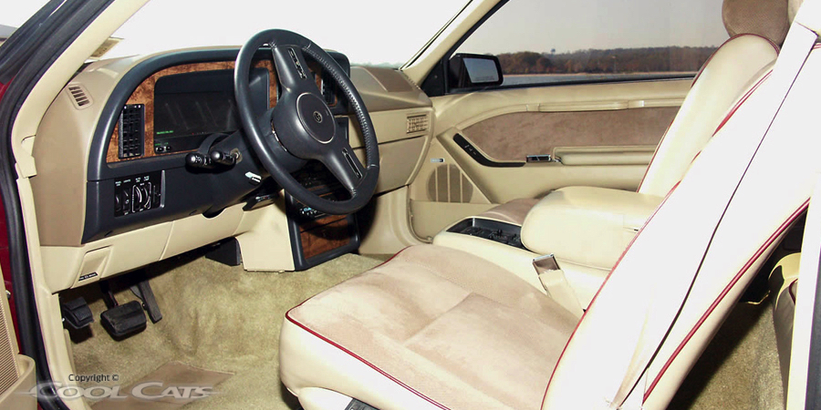

Question, Mine is a 1994 build, so I can assume it is a the same column. Do you have a picture of the column or issue in case Vern used something else in mine?
05-12-2018
07:09 AM
permalink
kitcarbp
1987 Cougar steering column used in my 2004 WCC chassis. No, you can NEVER assume anything VERN did. Always have to verify it , 3 times ! Here is a pic of the cougar column in my wcc build same as tbird

Mine the turn signal stalk and wiper stalk are in the same place, but mine are square. I bet they are the same as the location is the same.
05-14-2018
03:08 PM
permalink
FWB
Joey, i think the square style are earlier than 87, more like 79-83 or 84, like from a fairmont or cougar the boxey bodies
