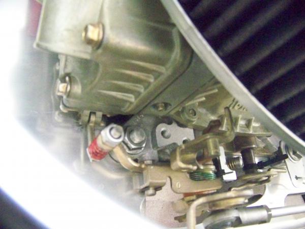

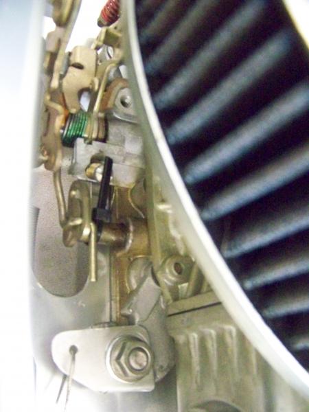

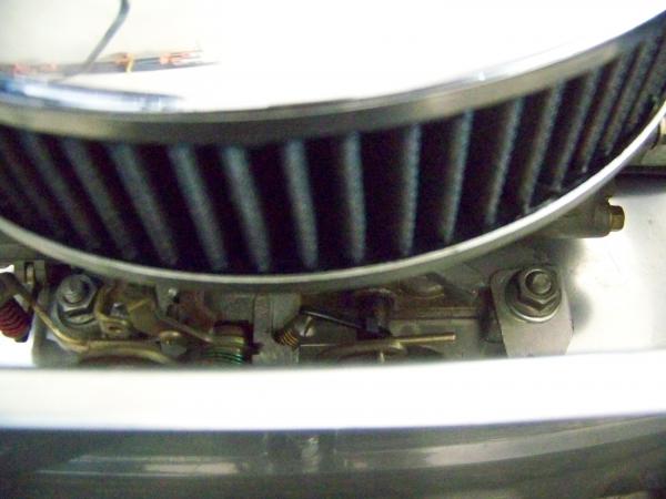

I was doing some fine tuning on my Cobra and suspected the secondaries on my Holley 750 vac secondary were not opening. I put a zip tie on the vac pod rod and observed that the secondaries are only opening about 25%.
I ordered a set of springs last night. Not sure which spring is in the carb now. The engine was dyno tuned by the builder.
Would you go 2 spring sizes softer or just 1? I have a turkey pan and it is a pain to change springs and would like to get it on the first guess.
