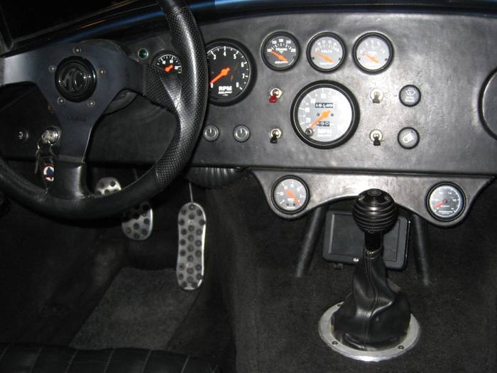

I made a little gauge pod for my wideband meter and a vacuum gauge and mounted it below the dash. I installed bungs in each collector. It works fine.

I recommend the AEM gauges . I have my sensor(s) about 2 inches downstream of the headers. I tried their digital gauge for a few years, but switched to the analog type. Looks better in a vintage car to me.
