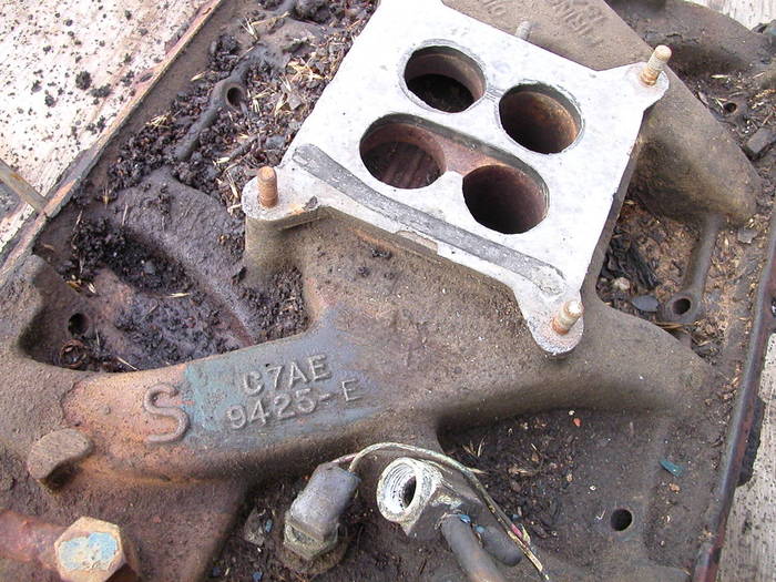

What can you tell me about this intake, other than it weight 86 lbs.? What does the large 'S'
mean?

Originally Posted by Dwight View Post
What can you tell me about this intake, other than it weight 86 lbs.? What does the large 'S' mean?
The "Q" in the fifth slot of the VIN indicates that you have the 428 "Q" option -- maybe you have 14 bolts in the exhaust manifold, yes? It was not a high performance engine, but that doesn't matter, it's a damn fine block and they're getting harder to find. Plug in "Q-Code 428" in google and you'll find lots of threads. The "S" on the intake manifold is found on the Q-Code cars, and they are hernias in the making so be careful.
The 'S' denoted an engine to be allocated to the Station wagon line.
Alan in Katy, TX
That's not probably true. I have worked on many 390GT engines of the era and they all had a big S like that on the intake.
