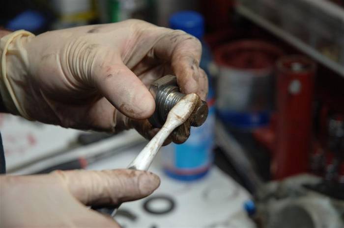

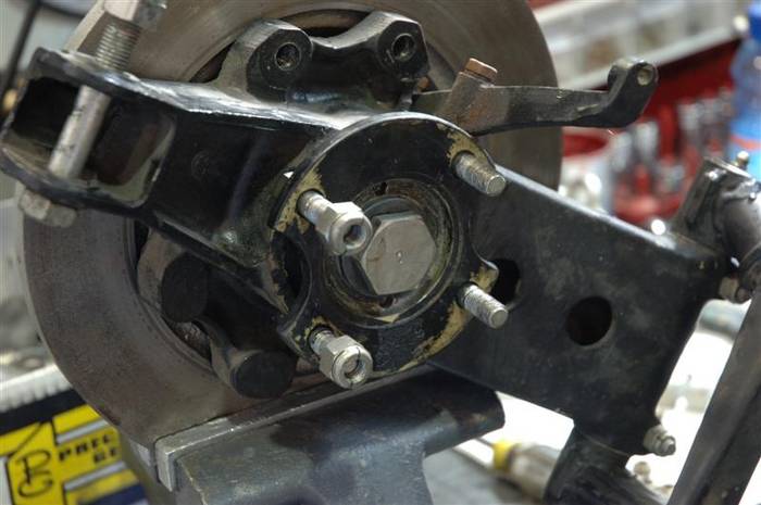

Toothbrushes are used to clean more than teeth! Just don't use this one again on your teeth!
  #42 (permalink)
Old 09-03-2007, 03:18 PM
David Kirkham's Avatar
Original Shelby Owner
Location: Provo, Ut
Posts: 6,990
The hub bolt has to be perfectly clean as well! Just cleaning one side does not do much good.

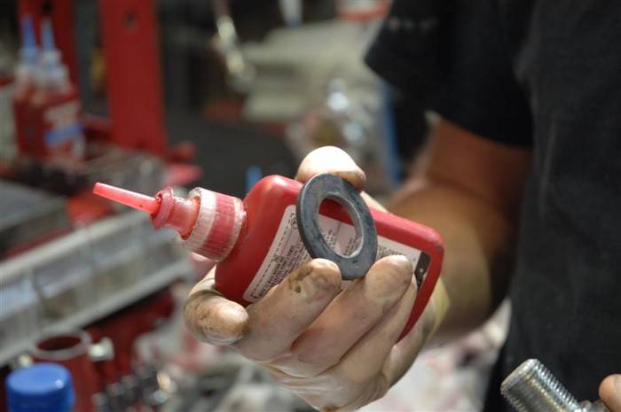

Sandwich then takes a HARDENED structural washer and bores the center out to 1 inch to go over the shoulder on the hub washer. You have to use carbide tooling to cut the washer. The washer will just laugh at high speed steel.

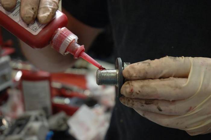

Posts: 6,990

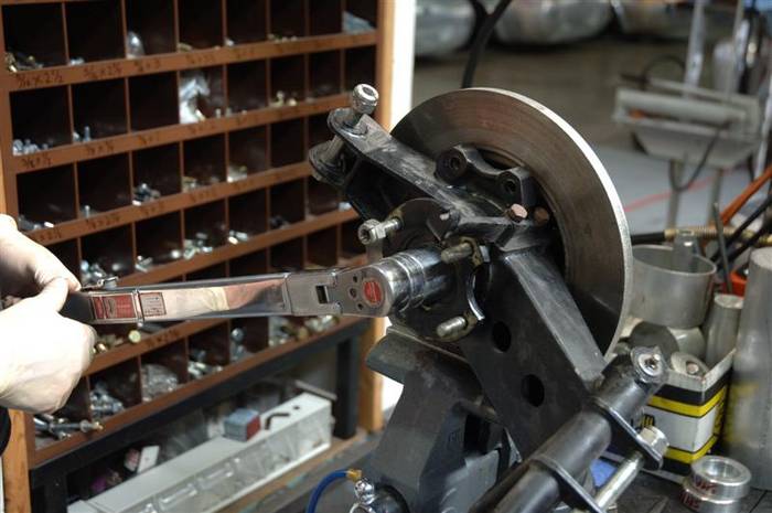

We like red loctite. I think they call it red because you will see red if you ever have to take it off! It sticks like mad. Maybe they call it red so you don't have to see red when your parts fall off if you forgot to use it.
  #45 (permalink)
Old 09-03-2007, 03:24 PM
Location: Provo, Ut
Posts: 6,990
Next,
Press the drive flange on. Put the new, hardened washer on the bolt and put in the hub bolt. Leave the stupid "lock tab thingy" OUT! Put it on the wall so you can impress your friends with your cool original Cobra parts.
  #46 (permalink)
Old 09-03-2007, 03:26 PM
Location: Provo, Ut
Posts: 6,990

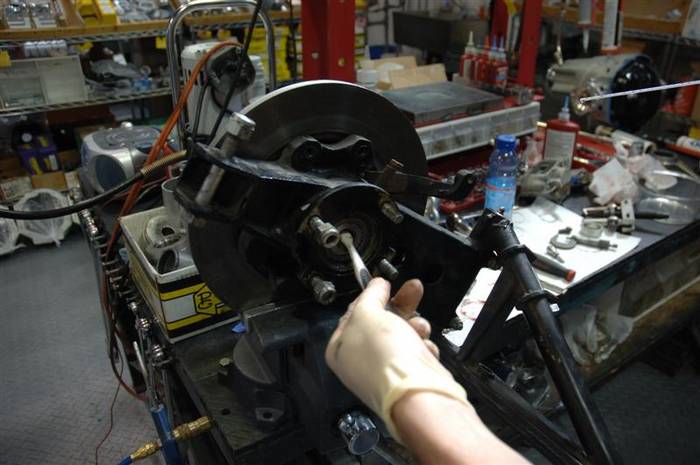

Torque to 225 foot pounds.
  #47 (permalink)
Old 09-03-2007, 03:29 PM
Location: Provo, Ut

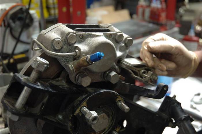

Posts: 6,990
Next bolt on the caliper with those special, cool bolts. Don't forget the washers!!! And, if you are doing the entire car, don't get the front bolts mixed up with the rear bolts. THEY ARE NOT THE SAME!!!
  #48 (permalink)
Old 09-03-2007, 03:31 PM
Location: Provo, Ut

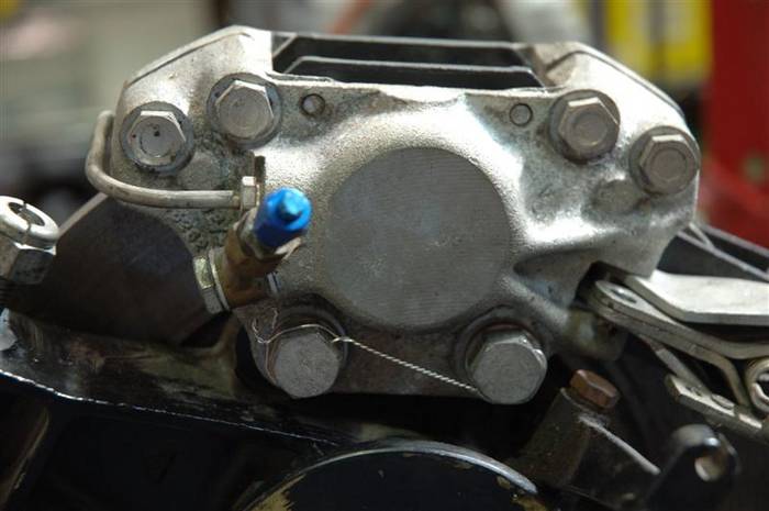

Posts: 6,990
Then, show people you care by making a nice looking job of your safety wire. We use 0.030 inch stainless safety wire. Notice the safety wire is run so that it will not allow the bolt to loosen. Also, notice the end of the safety wire. Sandwich was nice to the next guy. He curled the ends of the wire so whoever had to take the caliper off next didn't get 0.030 inch holes in his fingers.

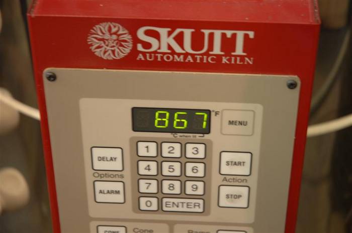

Our alarm just went off on our computer controlled heat treating oven. By the time I got back there the temperature was 867 degrees--on its way down from 900.

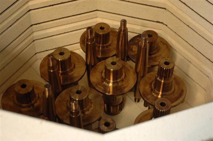

And here's a peek inside. CAREFUL!!! Those parts were just soaked 2 hours at 900 degrees and they are HOT!!!
Who knows what parts they are seeing inside? First correct person who names ALL of the parts that are in the oven gets a prize!

Bonus prize...
What alloy, heat treat spec, and WHY?

Front spindle shafts and rear drive knuckles... Couldn't answer on the alloy? Heat treated for maximum hardness and strength.
  #53 (permalink)
Old 09-03-2007, 03:48 PM
Join Date: Jul 2005
Location: Powder Springs, GA
Cobra Make, Engine: ERA FIA 2008/351W/TOP-LOADER
Posts: 526
Front Stub axle- Front hubs and rear drive hubs. Did I win??
  #54 (permalink)
Old 09-03-2007, 04:07 PM
Location: Provo, Ut
Posts: 6,990
FIA-ERA
I am not sure what a rear drive knuckle is?
You are right, however on your next post. There is a rear hub, front hub, and a front axle.
You win the first question.
Bonus question?
Why do we have a front hub AND a front axle in the oven?
Still open--alloy and heat treat specs????

Because you don't want a runny yolk? Good thread! Thanks for taking the time out to educate us.

David, Great post!! I always enjoyed books with pictures. I would think the front axles are matched with the hubs and keeping them together insures they get treated to the same temperatures as not to expand or contract differently? It seems there could be different variations in the metal strength and finished product if done separately? I'm not an engineer but I do like the late night questions. Thanks for your contributions!! Matt.

No...good guess, however. Are you sure those axles are "matched" to those hubs???
Look back through my post (including this one) and all the hints are there.

The kilns may be VERY similar...we just tweaked ours to work like we needed it to with special thermocouples.
