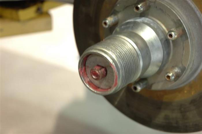

Here you can see the new 5/8 "D" washer we made to go with the new upsized outer bearing. The original spindle only had a 9/16 "D" washer and nut.

Here you put the new 5/8 castle nut on.

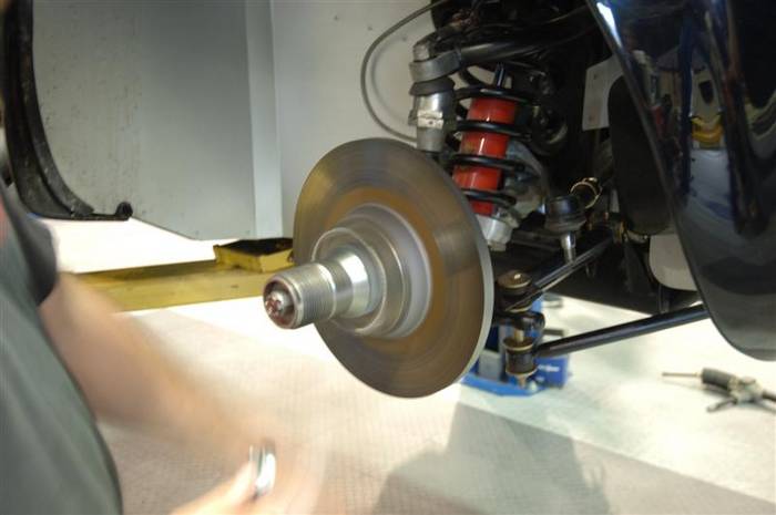

Here Jeremy is giving the hub a spin while he tightens up the castle nut. You do this to seat the bearing. Just keep turning and working the bearing down tight until the hub stops turning. Then back off 1/4 turn and put in cotter pin.
Done!
