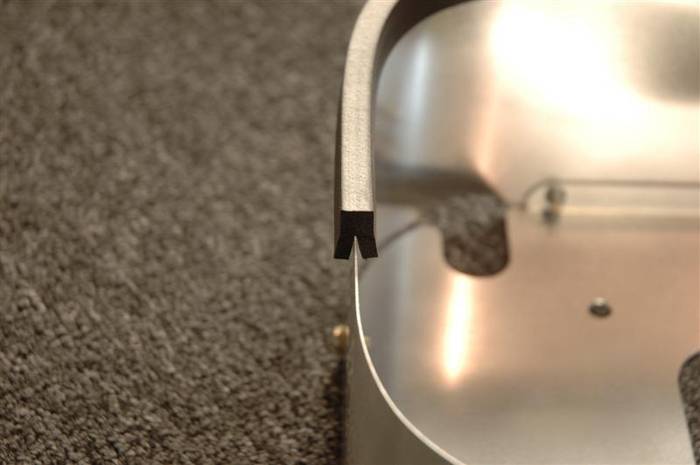

Gents:
Here are the pictures of the type of seal I am talking about.

That is the same weather stripping we use on the edges of our interior panels. Of course, on the actual cold air box, the seal would go all the way around. I just wanted to show you all what it looked like.
You would simply trim down the sides of the the cold air box to fit your hood, and then glue this weather stripping down. 3M trim Adhesive works GREAT!
David
