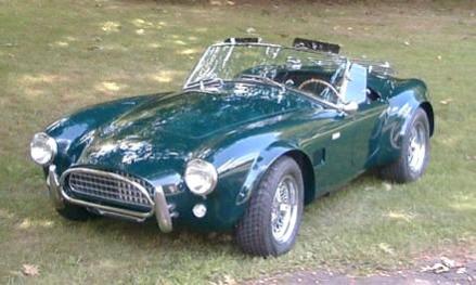

This is a photo from the ERA web page. I would guess they run a few screws thru the outer edge of the grille right into the fiberglass. I don't have one of these.

Jack, hoping that you are aware that "289" openings are considerably different from "427" openings. At least if the replicas are faithful reproductions.

yes, was aware of that, planned on building my own grill to fit, looking for advice on how attach without screwing or bolting through fiber glass , thought i would use expanded metal but not sure on best way to attach it .
