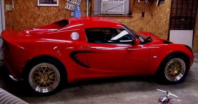

Are you sure you mean "bright, like chrome?" I haven't seen that for gold wheels, but here is a picture of the gold powder-coated Kodiaks on my Lotus.
Clay
