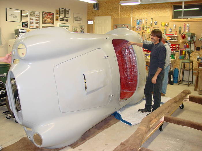

Anyone ever put a Midstates body on a rotisserie? I am redoing the undercoat and have a chance at a rotisserie but not sure if it is worth the money/effort.

I built a wooden cart to hold the body while I worked on the underside. I basically layed some 2x4's on the body in the "creases" and then built the cart upside down. After putting some scrap carpet on the cart, we flipped the body over and layed it on the cart. Worked out perfectly to get good access to the underside.

you could put it on a rotisseri if you bolt it through the holes for the front and rear bumper mounts but if the car is painted just tape everything off the best you can and use the roll on bed liner stuff it works great and looks awesome

cool, thanks guys. Once I get the road grime cleaned off I will decide if I should use the carpeted cart or roll on bedliner. I used the spray on liner for the firewall and am very happy with how it turned out so I will probably use something from the same product family on the undercoat.
