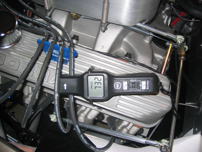

This is what I use -- works great, even when you attach it upside down.
