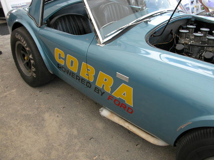

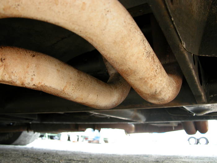

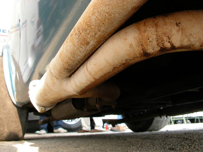

Looks lilke a tri-Y header system. When I was looking for under-the-car headers for my car, someone contacted me with a set of "original" under-the-car headers for a 427 cobra he once owned. He sent me pictures, and they were a tri-Y set-up as well. Space is a premium. I have 4 into 1 under the car headers like a traditional header.

Leave it to Professor Richards to provide...he was crawling all over this car (and the entire Miller collection) at SAAC 31.
Like a little kid in a candy shop.
You need to bring supplies with you Ron!!!!

very good, now what did they look like up ,closer to the engine?

Hello, go to the cobra restorers web site and there is a photo of the entire exhaust system assembled off the car. They are a big Y set up, two pipes drop down into one and that is what you see coming out from under the rocker panel. We had a set on 2498 but there was no easy way to get a muffler on there and make it look good, so we went back to a under car exhaust that exits in front of the rear tires.
