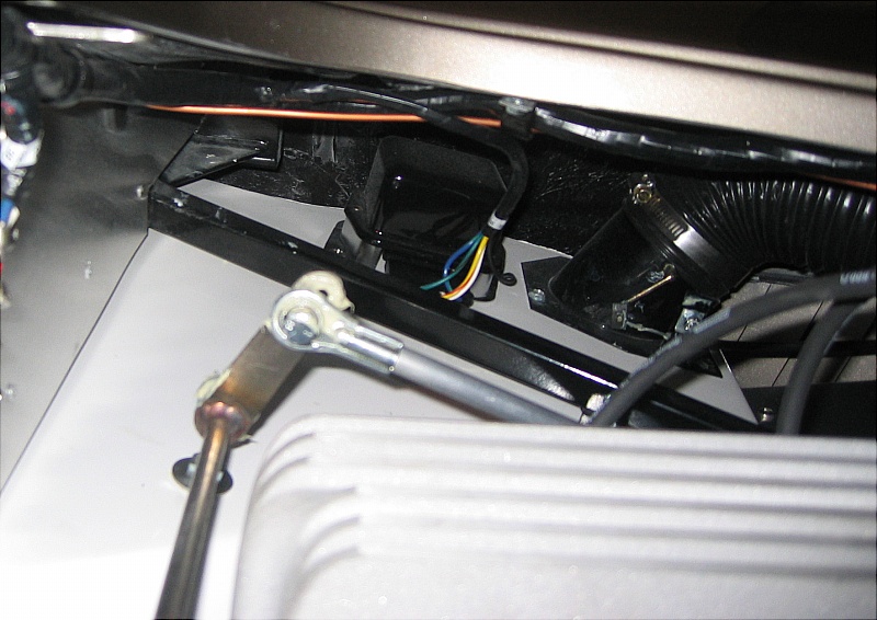

patrickt 01-05-2010 08:47 AM
Originally Posted by 428street (Post 1015485)
I did exactly what was mentioned above with Doug at ERA. Took the correct cover and drilled it out (the rivets) then I bought an "newer" internal from ERA, installed new rivets and bang it works fine. I had the original 60's style in there before and it worked but the red ignition light would come on at low engine revs.....
Do you have your regulator in the "stock" era spot on the driver's foot box? Or is it moved? It's awfully hard to see tucked up under there.
http://www.clubcobra.com/photopost/d...tagereg001.jpg
428street 01-05-2010 08:56 AM
It's in the stock ERA spot. I spoke to Peter and Doug at length about swapping the wiper motor and the VR (as it should be if you want the original setup) but it never went anywhere. If I remember it is doable but a lot of work. I have an original wiper motor as well but can't use it for now...
patrickt 01-05-2010 09:00 AM
Oh that's right. I remember that now. Yes, flipping the motor around is a huge PITA.
