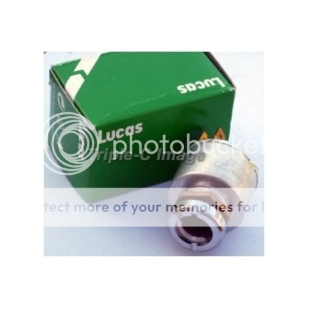

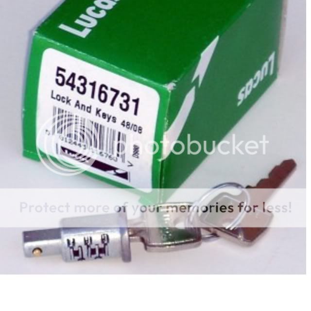

Well I didn't get a hold of Bob at ERA yet but will try again tomorrow.
In the meantime, I have found a source for the Lucas switch which has the correct bezel. I would think if you ran this switch through a relay to your starter solenoid you shouldn't have any problems.
The switch at $26.95 and the key/tumbler set at $14.95 sell separately.
http://www.triple-c.com/Products_and...31973&pID=1180
I have not ordered anything from this company in many years but I have seen them at many cars shows.

Another option is to run the Lucas switch with a relay, which is what Ken at Haywire did for me. This reduces the power going thru the switch. This has worked fine for me so far (just finished the wiring). Also, make sure the Lucas switch has 4 terminals and not 3. One for power, one for ignition, one for starter, and one for aux. Unfortunately, I am one of those that is all about originality.

I was told the newer Lucas stuff is now made in India with according quality.
Was there an accessory position on originals? I thought on, off, start was it.
