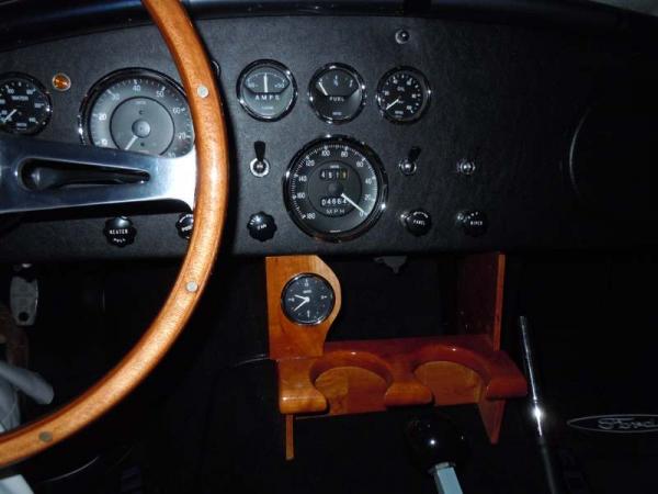

I got a Smith clock to match the other gauges. I think it looks great, but not sure what others think.

I would use a Smiths , or Autometer clock with a aluminum sub bezel you can make on a lathe. -- the Ford clocks are not repro'd and they are TOP money so a beter solution might be the above.

I've found the Smiths and the Auto.., but if you go to this link and look at the clock in the car t is not a 2-1/16th diameter. Galaxie clocks I've found have all been square, and only a couple of Falcon dash clocks, that aren't right either. Odd one, but I'm determined. Keep those cards and letters coming. thank you
Smith Clock Picture
http://www.clubcobra.com/forums/pict...d=5897&thumb=1 The diameter of the chrome ring is about 2.2".
