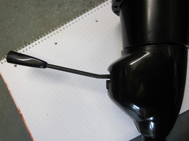

Old 04-29-2012, 12:20 PM
Join Date: Jul 2011
Location: warwickshire UK, wa
Cobra Make, Engine: RAM
Posts: 48
Wink
Update.....
pics of turn signal switch so far
(60's Hornet switch Part Number 39948L
and MGB cowl).....
Working on Dash so can't photo in place until work is complete...
Steve
Old 04-29-2012, 03:09 PM
rsk289's Avatar
Join Date: Nov 2004
Location: Cambridge, England, n/a
Cobra Make, Engine: 289 leafspring, r/p
Posts: 518
That looks like a standard MkII Mini switch. The slightly later switch is still readily available new from any Mini supplier, the only difference being that the later switch has a black button in the end. All MkII Minis had the chrome button - the button unscrews as the horn spring is behind it - you can either swap in a chrome button from an earlier switch, or strip the black and polish.
