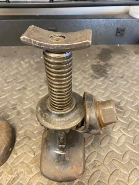

nkb 04-21-2022 04:06 PM
Bumping this old thread, regarding creating a proper curved saddle 12DL jack.
I found a 12DL with the L shaped saddle and a broken handle socket. I felt confident that I could get a new pivot off of another model, a cheap 10DL - I haven't received that yet - so the jury is still partially out, but I expect it will work.

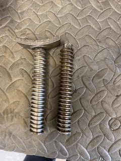

I wasn't happy about the notion of prying/grinding the L-saddle off the inner screw and then restaking the proper curved saddle in its place. So I used a different approach that has turned out well:
1. I obtained an inexpensive Shelley 6 inch jack. This has the proper curved saddle. I guessed that the inner screw would be the same thread as the 12DL. It is. I removed the inner screw from the "6 inch" by partially unstaking it on the bottom of the screw and then winding the screw up and out - importantly without removing the saddle.
http://www.clubcobra.com/forums/pict...ictureid=20225
2. I removed the double screw mechanism, from the bottom of the 12DL by grinding/prying the L saddle off. The normal procedure. This allows removal of the internal screw out through the bottom.
3. I cut 1/2" off the bottom of the "6 inch" internal screw (with intact curved saddle). This makes it the same length as the original 12DL internal screw.
http://www.clubcobra.com/forums/pict...ictureid=20226
4. I then threaded the shortened "6 inch" internal screw with curved saddle through the top of the 12DL outer screw.
http://www.clubcobra.com/forums/pict...ictureid=20227
Result: An original, factory secured, intact curved saddle on the 12DL. No workarounds (milling counterbores/spacers/screws) or blunt force staking required. Clean factory finish to the top of the curved saddle.
http://www.clubcobra.com/forums/pict...ictureid=20228

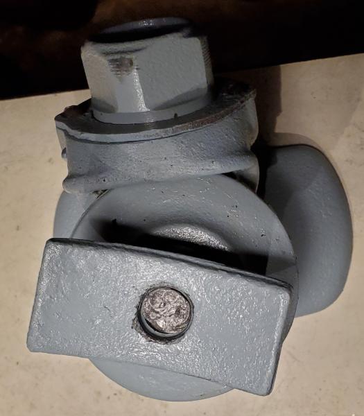

Harpoon PV2 04-21-2022 10:00 PM
I intended to go that rout, but the 10DL I got, had damaged threads and would not come apart, not from rust, just jammed but good!
Harpoon PV2 04-21-2022 10:03 PM
I should add, the factory staked the saddle on, it's crude, but it worked!
nkb 04-21-2022 10:25 PM
The factory "staking" doesn't look that crude. Certainly better than I could have achieved.
http://www.clubcobra.com/forums/pict...ictureid=20230
Note: I haven't even cleaned all the dirt off yet.

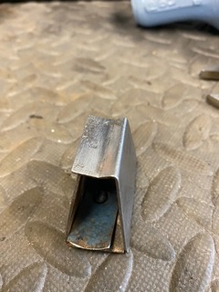

nkb 05-06-2022 02:47 PM

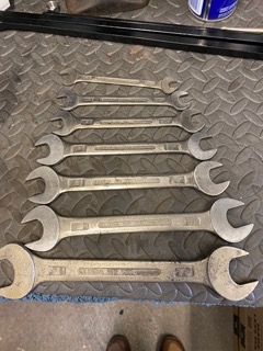

Continuing progress on my tool kit during the long wait for my car to appear. I obtained a vintage set of Elora 100 wrenches. The set actually included 7 wrenches but I selected out the 5 that are appropriate for the Cobra.
http://www.clubcobra.com/forums/pict...ictureid=20254

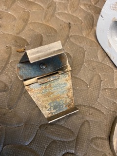

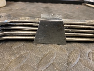

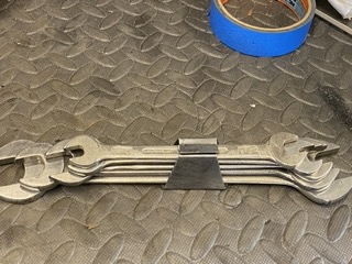

I looked at obtaining the thumb screw or the accordion style spanner clip. The latter, as everyone knows, is virtually impossible to find. The repop thumb screw was still an option but I found a vintage, hinged clip from the UK that does the job nicely and looks appropriate, if not absolutely correct. It has no markings. Interestingly there is evidence of a similar shade of blue that seems to appear on some of the original Elora clips.
http://www.clubcobra.com/forums/pict...ictureid=20250 http://www.clubcobra.com/forums/pict...ictureid=20251 http://www.clubcobra.com/forums/pict...ictureid=20252 http://www.clubcobra.com/forums/pict...ictureid=20249

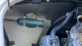

ALF 06-13-2022 12:44 AM
You're talking about 289.
Mount the tecalemit greas gun on the passenger footbox inside the engine compartment.
Mount jack and handle inside the trunk.
It will save you some space on the toolkit bag. ;-)

nkb 06-13-2022 12:31 PM
http://www.clubcobra.com/forums/pict...ictureid=20308
http://www.clubcobra.com/forums/pict...ictureid=20309
Yep, I have the clips for the grease gun and the clips for the jack and handle on order. I laid out all the various tools in one place just for a photo. No intention of stuffing all into the bag.
