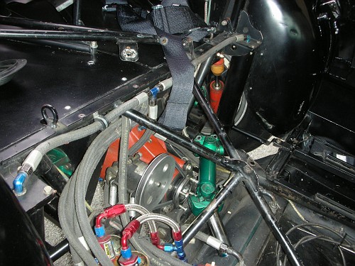

Right now just doing research for a friend of mine.
The Facet fuel pumps I believe are the old Bendix fuel pumps.
Gold Flo | Motor Components, LLC | Facet Purolator
Here is a picture CSX2299 with a diff driven oil cooler pump
I know some of the other Coupes had three electrical fuel pumps, one of which was used for the diff pump.
Which way was 2286?

2286 was the same as pictured, 3 electric pumps were for the fuel system. Diff pump was a Ford power steering pump used for the differential.
