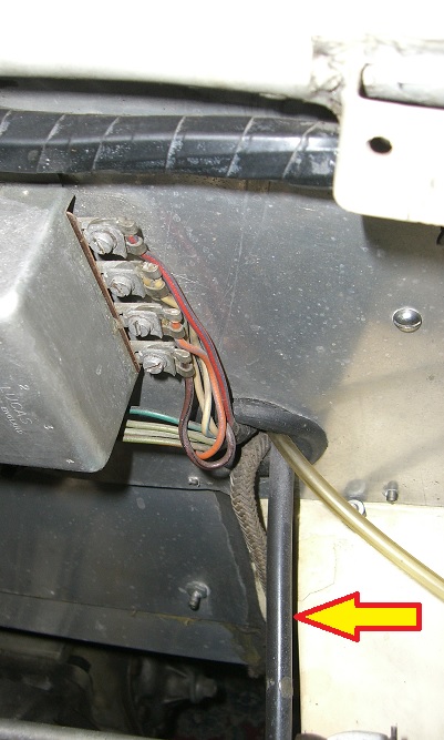

Which way is (should) the speedometer cable taking from the gauge to the transmission, on a 289?
Is it going via the engine bay or is it routed trough the transmission tunnel.
Many thanks for your advise/pictures.

Out through upper fire wall panel and down along side of the engine and transmission. It was/is very common for the cable sheath to be damaged by heat because of close proximity to or touching of the left rear exhaust iron header Y.

Hi Dan
MANY THANKS for the reply and the picture.
