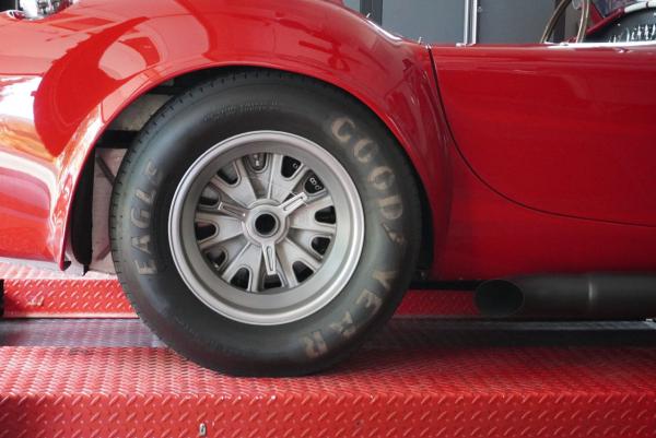

I've had stainless knock-offs against aluminum wheels for 29 years without issue. I've always used antiseize liberally.
[IMG][/IMG]
