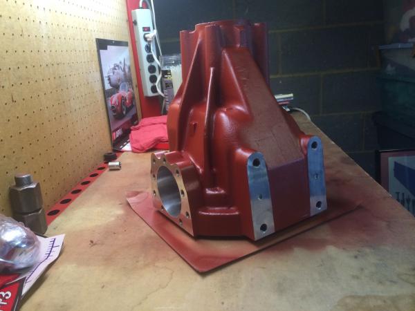

feadam 02-29-2020 12:34 PM
http://www.clubcobra.com/forums/pict...ictureid=18777This looks like color in the few I've seen painted original, now just letting it dry

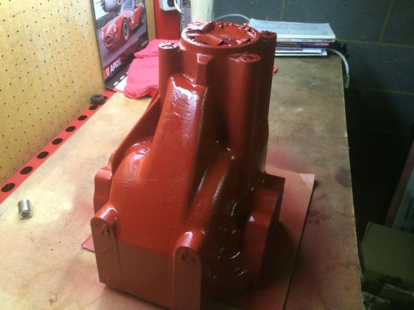

feadam 03-01-2020 02:57 AM
http://www.clubcobra.com/forums/pict...ictureid=18778 better picture untaped
MAStuart 03-01-2020 07:38 AM
I did not ask. What are you building? After thinking about it I haven't seen any original rears with the holes drilled on top. You should have painted that area too. Hey it looks good that color.
feadam 03-01-2020 10:06 AM
So I have a book with original AC factory build pictures and it shows holes on top, the new reproduced cases dont have them because they really aren't needed. Somebody will probably correct me but the cases were used in Aston Martins and maybe listers and I think the top holes were needed. Ive seen black and the red color on them but not sure which cars used what color. I think 427s used the red, not 100% sure. Gonna try to do an original type car at some point, first have to move back from England. Was gonna buy one from the many manufactures cars over here cant get it back to states

rsk289 03-01-2020 02:16 PM
On the subject of colour for differential casings, are you sure they were finished in red primer?
As a Brit with wide experience of sixties British sportscars of various makes, I know that many mechanical components were often finished in Glyptal. This looks like red oxide primer, but is very much tougher and resistant to chipping, wear etc. My Jag XK engine has the internal surfaces painted in Glyptal, which is still available. My Cobra's Kirkham diff is also painted with it.
https://www.electro-wind.com/glyptal...can-361-g.html
LMH 03-01-2020 02:50 PM
Roger, is it gloss for the sheen?
rsk289 03-01-2020 02:58 PM
1 Attachment(s)
Semi-gloss to Satin, Larry. Photo attached prior to fitting - you can even see the tin behind!
LMH 03-01-2020 03:41 PM
Very cool! The darker color makes me initially think you're correct. Going through a couple Dave Friedman's photos, the differential looks black in the photos but his photos are black and white, so color doesn't show well. The red oxide is close to what Ford was using on the 9" center sections of the time but yours fits better with Daves photos.
Hmmm?!
rsk289 03-01-2020 04:07 PM
I'd have thought the diff was painted before shipping to the US - probably?
I doubt AC would have been using Ford finishes on chassis/engineering parts.
It's tough stuff - much more resilient to damage etc. than a normal red primer. Used a lot here at that time for machine parts.
LMH 03-01-2020 04:42 PM
Our thinking at the time was more along the lines of industry wide usage of the red oxide, not just Ford. I asked a concours judge a few years ago about it and he said they look for a red differential. So that told me nothing!
I’ll post a couple photos later but I’m thinking you’re right here.
