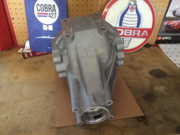

Old 02-25-2020, 07:34 AM
Join Date: Dec 2004
Location: Colorado Springs, Co
Cobra Make, Engine: Cobra FF5/BBM 482
Posts: 160
[IMG]file:///Users/aliciamatteson/Pictures/IMG_0589%205.JPG[/IMG] image of diff case

http://www.clubcobra.com/forums/pict...ictureid=18765
Old 02-25-2020, 08:05 AM
Join Date: Dec 2004
Posts: 160
Trying to figure out the picture posting think I have it, this is the aluminum case I bought.

Old 02-26-2020, 07:41 AM
Join Date: Mar 2009
Location: Mendota, IL
Posts: 697
I wonder why they drill and tapped the holes on top of the case? Whose hole are not used to mount it in a cobra. I will have to look at my Kirkham case to see if there drilled and tapped.
