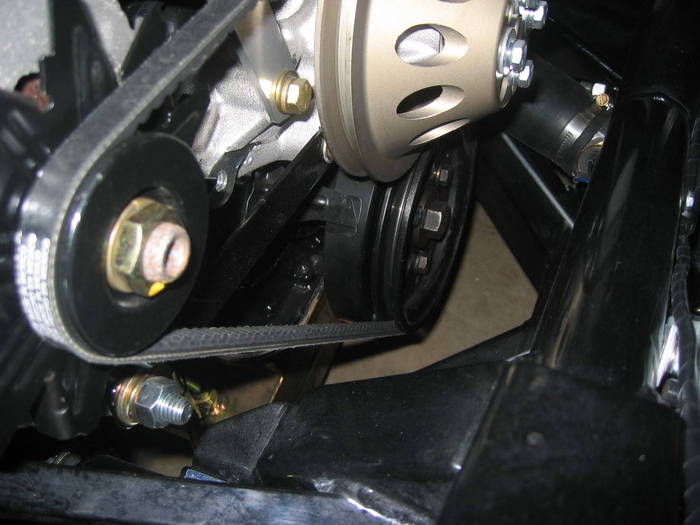

Then keep it very simple and do it like I did. Here is a picture:
http://www.clubcobra.com/photopost/d...um/pulleys.jpg
Originally Posted by hi-tech cobra (Post 826524)
Forgive my ignorance, but what do you mean 'underdrive' them? :confused:
You do not want your water pump pulley to be "underdriven" in order to save horsepower. That will cause you to overheat. Plug in "underdrive" and "water pump" for a search and you'll find many, many threads. The most recent one, as I recall, also included some pics of some very nice pulleys from the Kirkham bros. -- I think I remember that, but I could be wrong. It was a very recent thread though, like just last month.

Nothing you see there is fancy. The balancer and pulleys are all Jegs stuff, as I recall, and not on the expensive end either. The water pump is an Edelbrock. You don't need to spend a lot on this type of stuff -- it's the stuff that goes on the inside that tends to cost a bit more.;)
