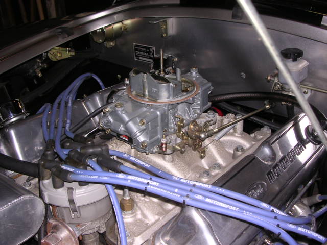

The Superformance number is stamped on a plate which is attached to the passenger side of the firewall. The plate is black. Your SPF is only 11 away from mine. The plate in the picture below is just above the carb. I'm surprised that you missed it, or that someone removed it!
I'm sure that the same number is on the frame, but I never went looking for it!

Well, I don't have any signs of a plate having been removed. Was yours mounted to your car when it came here from SPF?
Here is a pic I just took of my firewall (sorry, dark garage)
