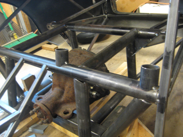

Well now. Time to address the rearend on this beast. I've
added in the diff crossmember, and the IRS box with a rollbar
support base that was a little more suitable to me over the
OE 3/4" getup. The box is designed for the Ford 8.8 IRS unit
and has just the right amount of room to fit it in through the
bottom or top without any trickery. There is also enough room
for a fullsize spare behind it ! Now on to some substructure
support work... Til next week.

Did quite a bit of work on the rear portion this week, including
adding the support structure for the rear deck (finally removed
all of the temp body supports), and added the framework and
supports for the fuel tank and rear QJ's. Boy did that feel good!!
She's almost 100 fully supported, minus the rollpan, which will
be hot on the agenda for next week. Oh, I also was able to get
the front rollbar and upper shock mounts tacked on as well.

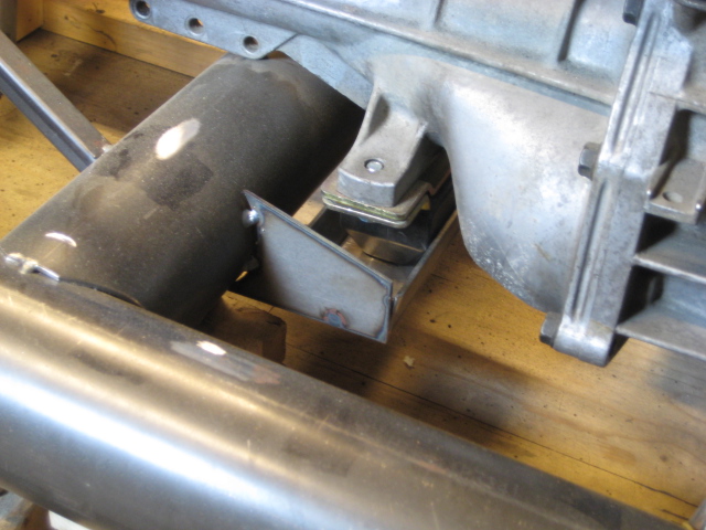

I was able to get the transmission and motor mounts in and
followed that up the following week with the shock tower mounts.

Bob, for the engine offset, I second Nick on the pinion angle...
In an original setup at least...
Mike.

Yeah, I did forget that one little thing.......
Great progress, keep posting pics when you can.
Bob

That's looking at it from the top of course, pinion by crown wheel et al.
