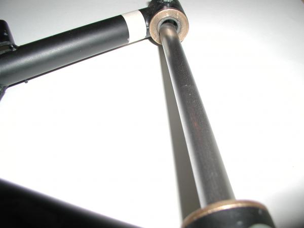

Unfortunately, getting the car back on the ground so that the alloy body could be started would not be as easy... I am still dealing with the garbage that my previous fabricator screwed me on. Control arms that are so misaligned that they can't even be bolted to the frame. Spacers that were cut with what looks like a hack saw, made out of the wrong material and not even cut to the correct width. The rear upper control arms are so bad that they will be totally scrapped - warped tubing, horrible welds, misaligned bearings, incorrect widths, etc. Lucky for me, Craig was able to address and correct all of these issues.

ScratchBuilder 08-31-2016 10:55 PM
That chassis came out nice! I'm sure Craig will quickly sort out the suspension. His parts are nice and aligned :D
Those A.... control arms look familiar and and don't pivot with the ends out of alignment and than there's the improperly fitted bushings.... :CRY::mad:

Unfortunately for me, my previous "fabricator" over reamed the bushing in order to get enough play for the bearings to align with the mounting holes on the frame. Now, both the brand new bushings and bearings that I paid good money for, (not to mention the exorbitant labor charges) are garbage. I don't know how he sleeps at night. Most of his previous New England customers won't even speak with him anymore. Anyway, he will deal with his own bad Karma eventually.
Craig has pretty much fixed most of Acton's screw-ups so the build should be a bit easier moving forward. Not that anything about these cars is easy...

Mongoose and Scratchbuilder The ends on those control arms could be brought into alignment with heat in the right place and letting it cool. Its called flame straightening . No manual bending involved. What you see there happens all the time even when it is welded in a jig. If all the jig holes were nice and tight and you fully welded your part you would probably have a hard time getting your part out of the jig. And you would have a harder time getting it back in the jig.
Mark
cobrakiwi 09-02-2016 05:07 AM
I was able to flame straighten one of the front lower control arms,
with my TIG torch tip after I cut one end off and set it up in my jig before introducing the flame:LOL:
