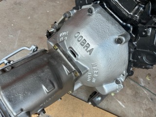

Connection made with the help of my brother Joe.
Centerforce clutch installed, all torqued and alignment made.
427 to cast iron FOMOCO bellhousing to 4spd Toploader.
Phew
FIA289, 1795 and CompFi like this.
