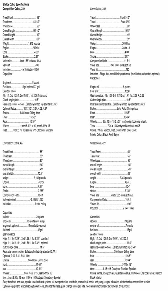

Default Factory 427 wheel base and widths
We just got a set of cobra molds CHEAP from a guy and we just got the first body done. We typically build new chassis with corvette suspension for all kinds of cars and I have a 2002 C5 transaxle we are looking at putting under one to make a Lamborghini and Ferrari killer. I can’t find good sources for wheel base and the rest any where can you guys help me out?
Please don't hate me for using the corvette suspension its so light and so cheap i can't help it.
