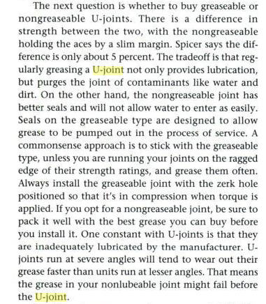

Default Nothing is Simple...
Here's another viewpoint from Jim Allen, the author of Jeep 4x4 Performance Handbook:

On a Jeep , that wouyld see a moderate amount of off road playing, I would probably use a high quality greasable joint if the engine was stock or of moderate horsepower---the dirt and water extraction during the greasing process is highly overrated as you will only purge one of the four corners( the one that the seal pops first)
The miles that get put on one of these cars , lubrication will not be a problem that comes into play---strenght is
The shorter the driveshaft the greater angular difference from misalignment issues
But-----I'll let you choose what ever time bomb you want to put by your right hip---

Old 07-15-2008, 01:42 PM
Posts: 22,025
A 5% strength difference makes greaseables a time-bomb?

In the case of a 447 in FE engine---yes and the clock is ticking with every clutch release
And the strength difference between a 1350 spl series joint and one of your greasable ones of whatever size is way more than 5%--the torque capacity of a greasable joint is probably more than 5% depending on whether you have the zerk hole in compression or not---I've seen several driveshaft failures and they were mostly all well lubed
Its your choice and yours alone on what you choose but I hope that this exchange has opened some eyes as to choices to be made other than ""shall I get the $8 joint or the $25 joint?"

We're not discussing cheap u-joints, only Spicers. You know I respect your experience, but so far I have only found two written texts that actually discuss the strength difference between two Spicer u-joints of the same size, one greasable and the other sealed. The first was the handbook I cited and the second was an article in Four Wheeler that, apparently, had a metals engineer test the u-joints and he reportedly "showed the strength difference claim to be a myth." Unfortunately all I can find are references from people who have read that article, not the article itself. Perhaps you know of some authoritative text that shows sealed u-joints to be significantly stronger than greased ones? You would think that if that was true then Spicer would certainly tout that in their advertising, right? Remember that Jeff's question was premised on the fact that he had already chosen Spicer and that these u-joints were for the rear only, which are easily reached to grease. With that said, let me ask you this, if there was indisputable evidence that there was no significant strength difference between greasable and sealed would you still opt for the sealed units?
