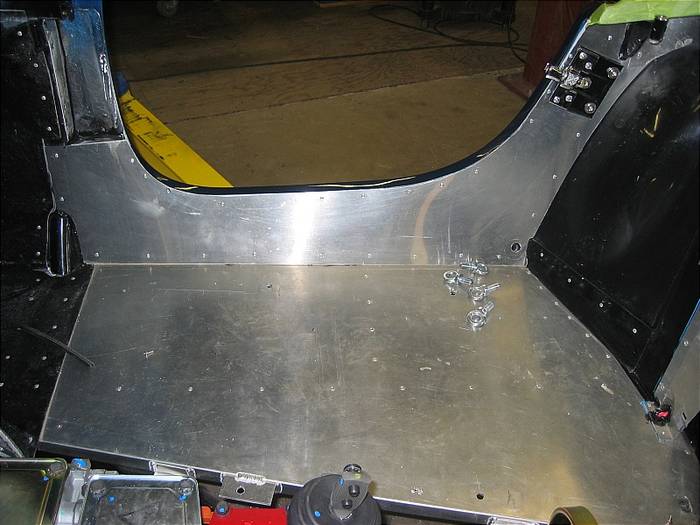

This might give you some ideas...

What am I looking at? I don't want to bolt my seats down to the cockpit aluminum floors, just not solid enough in an emergency stop or accident...

That's the aluminum floor, where the seats bolt down -- similar to the original. Here's a shot from below. Remember, so long as your belts go to the frame (and not something weak), your seats could literally be velcroed to the floor (well, maybe not velcro).
