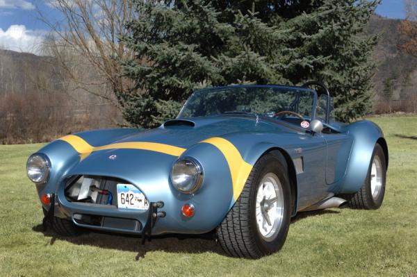

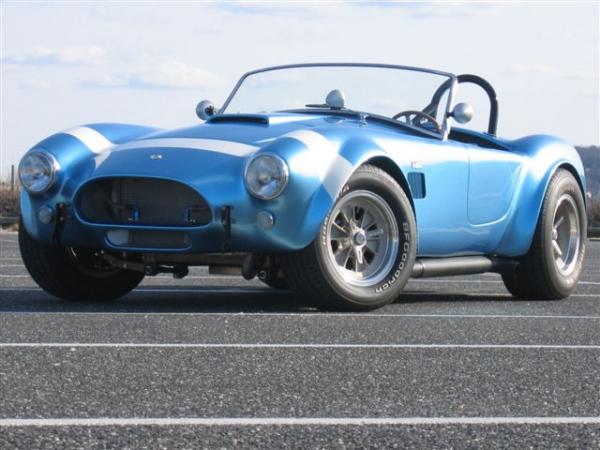

is this the side exhaust arrangement stock from shelby or is it the side pipe one ? or is it all race team specific ?

btw how sweet are these 2 eh? b@lls out awesome imho

The 289 "side pipes" varied a lot by car and by event/timing. There are the "Nassau" type setup and other styles of sidepipes used on the FIA and USRRC cars.

One comment about side pipes. My car has pipes like the second car pictured in that the outlet is turned down about 30'. This cause a dust storm especially at a car show on grass. NOT a way to make friends. I have since replaced them with "real" mufflers. I have a pic of just the pipes on the floor but cannot upload it for some reason?

Most everyone wants to make their car look they "Way they were". Most definately at the expense of "Some" power. ...Header science was in its infancy in 1963 & 1964 when the 289 Cobra was being raced. The FIA and USRRC cars had sidepipes tucked under the door and this design mandated a very short primary header pipe, much like what is today called a Block Hugger type, the primaries were only about 10-12" in length. Very poor design by todays standards, but thats how it was. The picture of the 1st car shows the use of a more modern header with primary tube length (to develop & maintain torque) and then the pipe attaches to it and "Angles" towards the outside.
