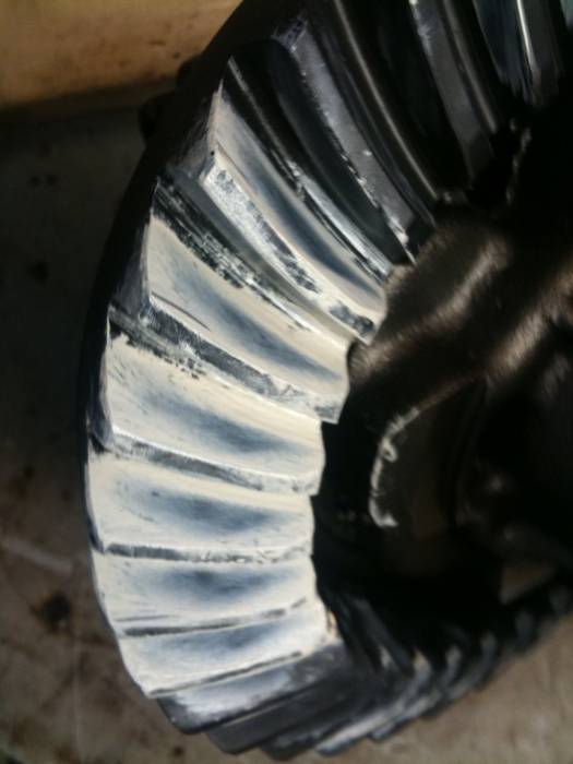

Default Ring and Pinion Pattern-Look OK?

I think it looks good. Nice cigar shaped pattern.

How's the backlash? (Is it within limits).
Yes, it's within spec.

Looks good to me.
