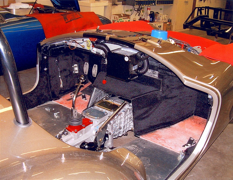

10-29-2010, 08:04 AM
Posts: 22,025
On ERA cars the tunnel is like a metal box that you just unscrew and pull off. Here's a shot with my tunnel off.

Posts: 22,025
Originally Posted by DougD
On an ERA, do you have to drill out rivets, or was it really made to be easily removable, and, if so, how did they approach the problem?
It was made to be easily removable. You just take out the seats, undue your shifter, take out the fake dash tubes, then unscrew the screws and pull it out.
