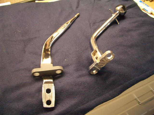

I had the same question a long time ago.
[IMG][/IMG]
[IMG][/IMG]
Also, look up the post on "Flat Chrome Hurst Shifter Replacement" thread on this forum which explains exactly what I did with my toploader. Regarding tearing the rubber boot to get it off, just unscrew the existing shifter knob and release the spring inside the shifter and remove the non-working reverse lock out wings. Very easy. Good luck.

Here is my problem. Shifter handle is offset in the 4:00 position when in neutral and it's too tall.
http://www.clubcobra.com/photopost/d...479_Large_.JPG
I need to convert my Ford style mounting plate to an adaptor for the Hurst style mounting design.
http://www.clubcobra.com/photopost/d...481_Large_.JPG
http://www.clubcobra.com/photopost/d...482_Large_.JPG
http://www.clubcobra.com/photopost/d...-5380015_w.jpg
These pictures are small for some reason, larger ones are availible in my gallery.
