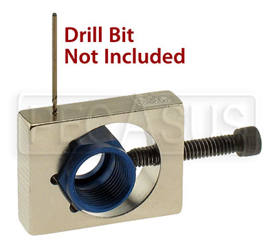

One question, is it possible to drill these 12 point bolts/nuts for safety wire? Do you think a jig like this one with a cobalt bit would work?
