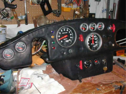

Default Cutting the holes for the gauges in the covering
Hi guys while we are at it..at what stage do you cut the leather or vinyl to accommodate the gauges.
Assuming one has cut the dash blank gauge holes, I next cover the blank with its appropriate backing and cover. What or how much backing have you guys chosen to go with...(slight padding or not). Last step do you now turn it over and cut out each circle with an exacto knife? Did you leave something to fold inwards and glue down or do you rely on the guage to clamp it? Also I assume any gauge bezel will cover most edges.
Tell me how you guys went about the task?

Whaler,
I covered my dash in tanned Elk skin that I dyed black. I backed it with 1/4" closed cell foam that body and upholstery guys use under vinyl roofs. I used hot glue to attach the foam to the dash; which was already cut out for the gauges. If you have to seam the foam or round an edge then use wide packing scotch tape.
I applied the leather with hot glue and cut out the holes from the back side of the dash with a razor. I don't believe I had much extra material because the gauges overlapped the dash holes a bit.
Roscoe
Roscoe

Whaler,
One other thing:
Once I got the gauges in place and tightened down I applied a bead of hot glue to the them, from the rear of course, to keep them from loosening up.
Roscoe
