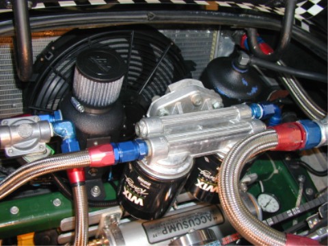

I have a pcv valve on the valve cover and runs into the back of my Demon carb. I was pushing a slight bit of oil out of the drivers side breather. Just enough to annoy me. So I installed a remote breather and catch can. I welded on an AN fitting on the valve cover. Now it's dry as a bone. I also installed a filler cap on the passenger side.
http://www.priveye.com/dls/jazcan2.jpg
http://www.priveye.com/dls/jazcan.jpg
http://www.priveye.com/dls/fillers.jpg
Roscoe
